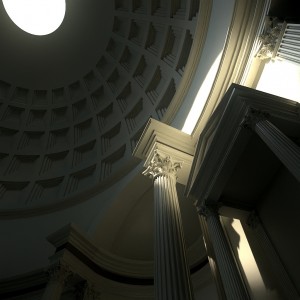

I am finding luxcore to be superior to regular cycles when rendering my scene, which is the Roman Pantheon. A challenging scene to light due to the singular circlular opening in the roof, the oculus. I prefer to light with a single HDRI, to get the most realistic lighting.
However, the issue I am having is that when attempting to use caches, photogi indirect and/or environment cache, i have to wait 20-30mins before the render starts, if it starts at all. Is this because of my complexe scene (>100 MTris)? I'd prefer to use the caches, since when it works I see the speed improvement.
Running Blender v2.90, Win10 64bit, nVidia drivers: 452.06
i7 3770k /w 24GB ram, 980 GTX
Image0028_pregamma_1_durand_spatial_90_range_7.5_base_4.8_postsaturation_1_postgamma_1.jpg

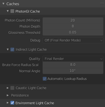

Sharlybg: Sure, see attached. I've tried photongi with default settings. It is currently turned off in the screenshot, but i was using default settings.
Re: Very long wait for caches enabled
Reduce your photon count to 2 million instead of current 20 millions.
reduce your brute force radius scale to 1 instead of 8 and try render again.
Brute force radius scale has no influence on the cache building time, it only influences rendering performance after the cache is built.
