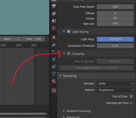

Sharlybg wrote: Wed Oct 07, 2020 10:26 am What is your clamping value ?
Hi Dravia! you mean this?
Its unchecked....

ok I needed to turn it off...its 55 minutes...and 1000px it does not make much sense...I hope I am doing wrong I really hope so hahah

there it is necessary to set the maximum brightness value for any pixel in the image.
try it, put 1, and it will get a little dark, but the fireflies will disappear.
then, gradually increase the value until the fireflies reappear.
well, or give me a scene, I have 15 minutes of time, I'll see.

Thank you ! I do know the video. It is hard to remember where and when to go to check it. Also the explanation about the feature is not really clear. I just repeated what you did and put the clamp value on 50. It could be nice to understand why and what I am doing that.

Set the Clamp value to 1 first.
Make a test render of a small section of the image.
Then set the value to 2-4. Check again.
You need such a value when there will be no fireflies, but the scene will not lose in lighting.
Most likely, a value in the region of 5-8 will suit you.
Yes, the lower this value, the longer it takes to render.
Values below 20 are used for completely flawless, perfect results.
The fireflies should also disappear at 75 if the Clamp is set correctly.

Indeed the clamping feature at mac brightness 5 give me a almost free fireflies...at 5500 samples...
I guess...then a render of 1000 x 1000 will take 4 hours.
ok I exaggerated driven by my frustration: It will be around 1 hr for 1000px
