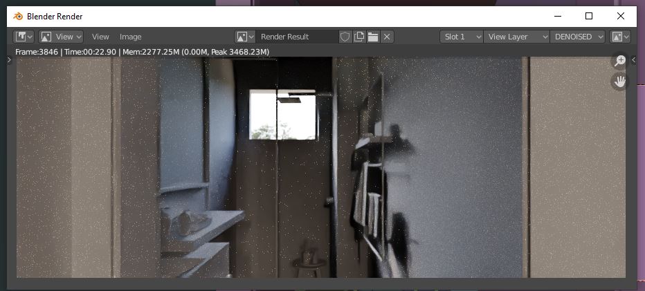

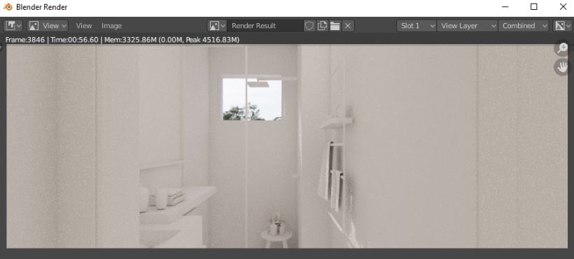

Hi everybody.
Why this is happen? Lights in preview render are so different from final render.
Preview
Final

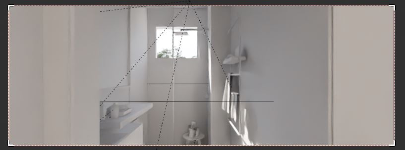

Sharly, are caches view dependent? Because I tried to generate caches from this view (original caches were computed from the living room) and it returned a different look.
I´ll send you the scene.
Add cache location

Leandro Oliveira wrote:
Fri Sep 25, 2020 9:58 pm
During viewport rendering, caches are disabled (in order to avoid pre-processing time) and the default number of light bounces is reduced (to increase rendering speed). This may produce a darker rendering if you have a lot of indirect light.
This may explain your problem.
Cache entries are view independent but the number and the position of cache entries is based on the camera used to create the cache.
The very first step of cache creation is to fire "visibility particles" and mark places where they bounce (4 max. bounces is the default setting). The cache entries are create there and only there.
If you have a building with 100 rooms, the cache will be created for the room where the camera is and for near rooms reachable in 4 bounces. Far you are from the original room and less likely the surfaces have cache entries.
So if you are doing an animation inside the same room, you can reuse the cache, if you move across many rooms, you need to update the cache.

Dade, that´s it! I have to update cache, because I have other rooms. Thanks a lot!
