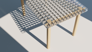

Hi. I have been preparing a scene in Cycles and after a bit of thought I decided to finally make an attempt with Luxcore.
This is what I have so far from cycles:
The problem that I find with cycles is setting the acrylic surface correctly. As you can see the only way that I found to get the light pass through the surface and cast the grid shadow on the floor was to use a light pass plugged in the shadow rays. The drawback: I lose the shadow of the acrylic on the floor.
Anyways ...I have heard so many good things about luxcore speed and quality I decided to give a try.
This is my first attempt with luxcore ...I did not tweak anything in the scene. Added a sky + sun. The acrylic ...its not looking good, but its probably cause I just copy the glass material from the sample scenes in your web.

I am not super convinced by the look. I believe it looks like solid glass even if the material I picked is glass and changed the IOR to acrylic (1.492) It also looks that is darkening the light that goes through it and the shadows cast on the floor do not have the grid detail. As I said I did not experiment so much , might be I need to increase bounces ? Also the acrylic have the typical dark edges...those ones I got rid by using the light pass node in cycles.

Actually, the Cycles rendering is totally faked, you can obtain the same result in Lux but I assume it is not what you are looking for.
This is due to the limitation of a plain path tracer like Cycles (or Lux in the default configuration).
First of all you need to enabled hybrid rendering to be able to efficiently render caustics and see a grid of light on the floor (by using path tracing + light tracing). They are SD paths: Specular(=glass) + Diffuse(=floor material) aka caustics.
Second you need to render SDS path too (Specular+Diffuse+Specular) to render the light going trough the glass, hitting the wood, going trough the glass again and hitting the eye. SDS are very difficult to render and only few render can render that kind of light paths. Lux can if you enable the caustic cache.
Short version: it is a lot simpler if you can post the scene and we can set up the rendering for you.

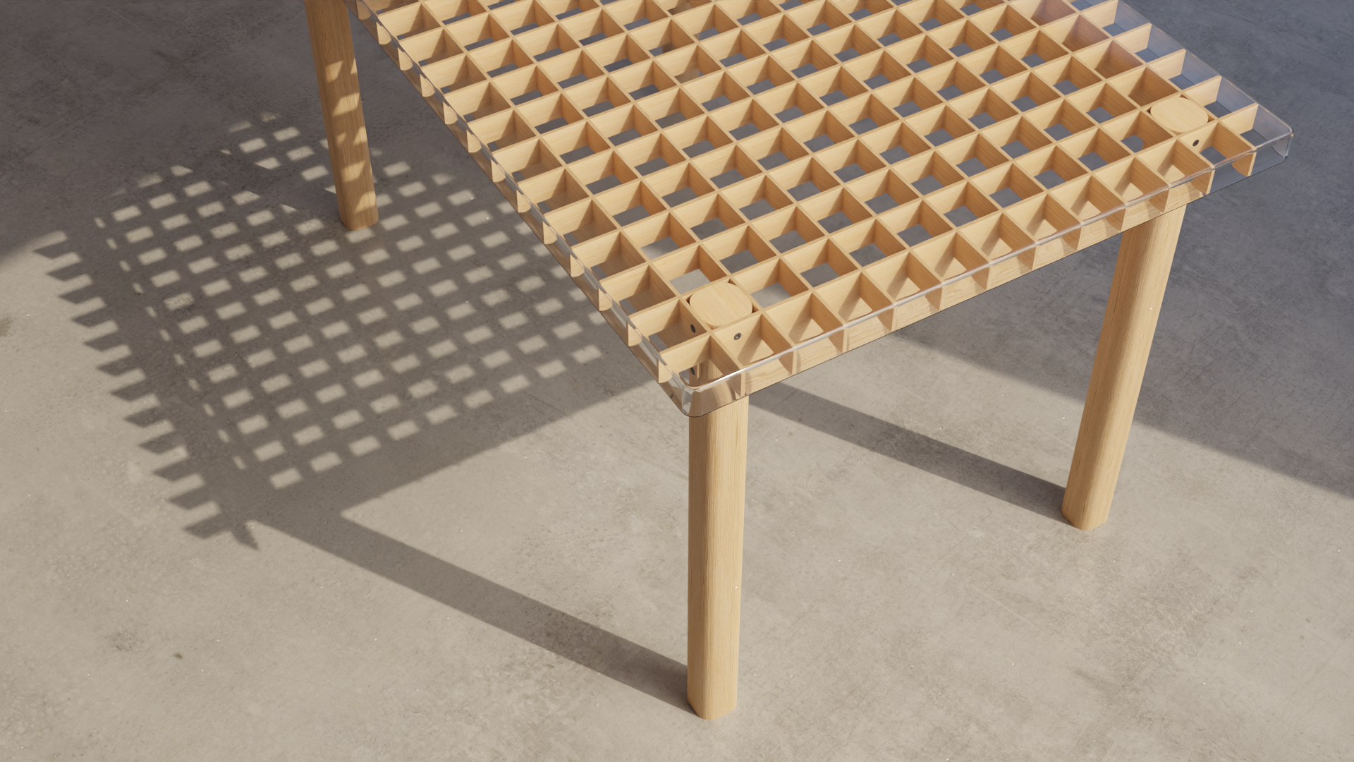

I have been watching more Dravia videos and also reading what you described. Now the light trace is active and looks way more realistic that all the hacks I needed to do in cycles. I also learn with the tutorials that the glass an advance section in the output where I needed to change the shadows to white....and now I can see the plastic as it should be! Its getting closer....
I noticed in the video tutorials from Dravia that sometimes he adds an homogeneous node to the volume in the glass materials...As I understand I do not need to do that with acrylic.
I do notice the plastic still looks like a solid thick glass...in the refractions, specially in the corners...I am wondering if that is cause I built it mainly using modifiers. I will give a try by building it from scratch without modifiers, only with the subdivision one...I am thinking if the solidify is messing something...
It feels the acrylic closer to a magnifying glass than a crystal clear plastic. Dont you think so ?
Here my latest tryout .
