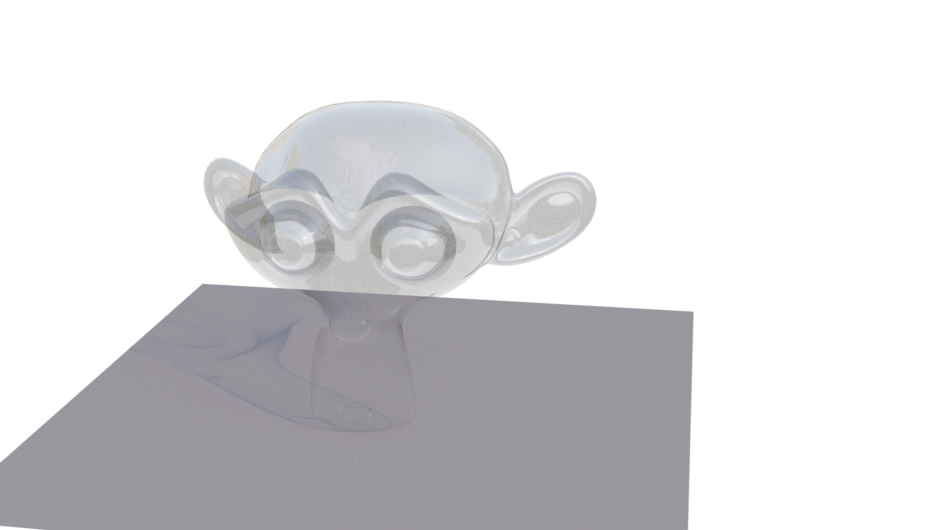

I noted that using Transparent Film, Glass material with Architectural option checked is rendered with alpha channel. I imagine that using real glass material, it´s hard to get an alpha channel because it´s necessary to distort the image behind it. But, anyway, is it possible? Maybe, using passes?

Indeed, I really miss the " transparent glass" option in Cycles. Though using that option you won't get any distorted refraction, it's pretty useful for rendering image assets for 2D designers.
Re: Transparent Film and glass material
If you check the 'architectural' option for glass as Leandro mentioned, you do get a non-distorted 'glass' with alpha transparency if I understand your query correctly?baoyu wrote: Sat Dec 26, 2020 10:03 pm Indeed, I really miss the " transparent glass" option in Cycles. Though using that option you won't get any distorted refraction, it's pretty useful for rendering image assets for 2D designers.
Sorry, what I want is to get real glass transparent. If you check the architectural option, it will hehave like its ior been set to 1. If you try the cycles transparent option under render properties>Film>Transparent>Transparent Glass, below, there's a option called Roughness Threshold meaning any glass with roughness been set above this value would be opaque.zeealpal wrote: Sun Dec 27, 2020 4:55 amIf you check the 'architectural' option for glass as Leandro mentioned, you do get a non-distorted 'glass' with alpha transparency if I understand your query correctly?baoyu wrote: Sat Dec 26, 2020 10:03 pm Indeed, I really miss the " transparent glass" option in Cycles. Though using that option you won't get any distorted refraction, it's pretty useful for rendering image assets for 2D designers.
For now, I could render in Luxcore and steal the alpha channel from the cycles render and composite them together.
Thanks, I wasn't aware of that previously, just tried it I see the difference, cheersbaoyu wrote: Sun Dec 27, 2020 10:03 pmSorry, what I want is to get real glass transparent. If you check the architectural option, it will hehave like its ior been set to 1. If you try the cycles transparent option under render properties>Film>Transparent>Transparent Glass, below, there's a option called Roughness Threshold meaning any glass with roughness been set above this value would be opaque.
