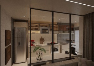

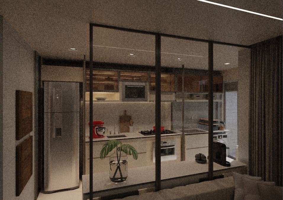

Guys, another question about caches.
Why a render with caches returned me a different render comparing to a render without cache? And, in my cached render, light seemed to leak to other parts, for example, inside the microwave (it´s not supposed to have any light inside it), and above the cabinets.
Thanks in advance
Thanks in advance
