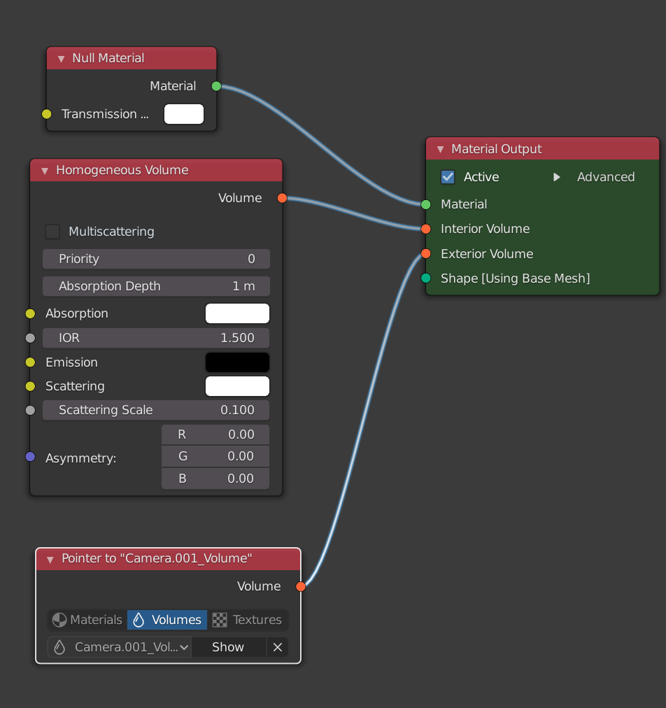

I'm sure I'm doing this wrong. I've updated the Cube shader like so:
I don't want to keep bugging you with newbie questions. If there's a tutorial I'll take a look (I couldn't find any so far..)

Put your homogeneous fog volume node into an own volume node tree (like the camera volume you have now).
Then use a pointer node to refer to this fog volume both as interior volume of the fog cube and as exterior volume of the camera.
Which I assume would be something like this (not assigned to anything in the scene)
Then use a pointer node to refer to this fog volume both as interior volume of the fog cube[...]
This for the interior:

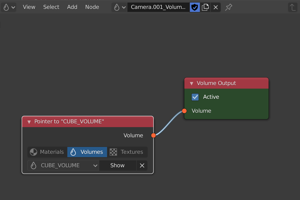

[...] and as exterior volume of the camera.
And here I'm not following.
When I add the pointer to the camera volume I don't see an exterior node socket:

phoenixart wrote: Thu Sep 03, 2020 10:10 pm And here I'm not following.
You can select CUBE_VOLUME in the camera volume dropdown.

Selecting CUBE_Volume in the camera volume dropdown did the trick.
Now the result is different from my initial setup, it looks darker and dimmed, but I guess it's just a matter of tweaking the settings in order to bring back more light into the scene.
Thanks again for guiding me through this setup.
