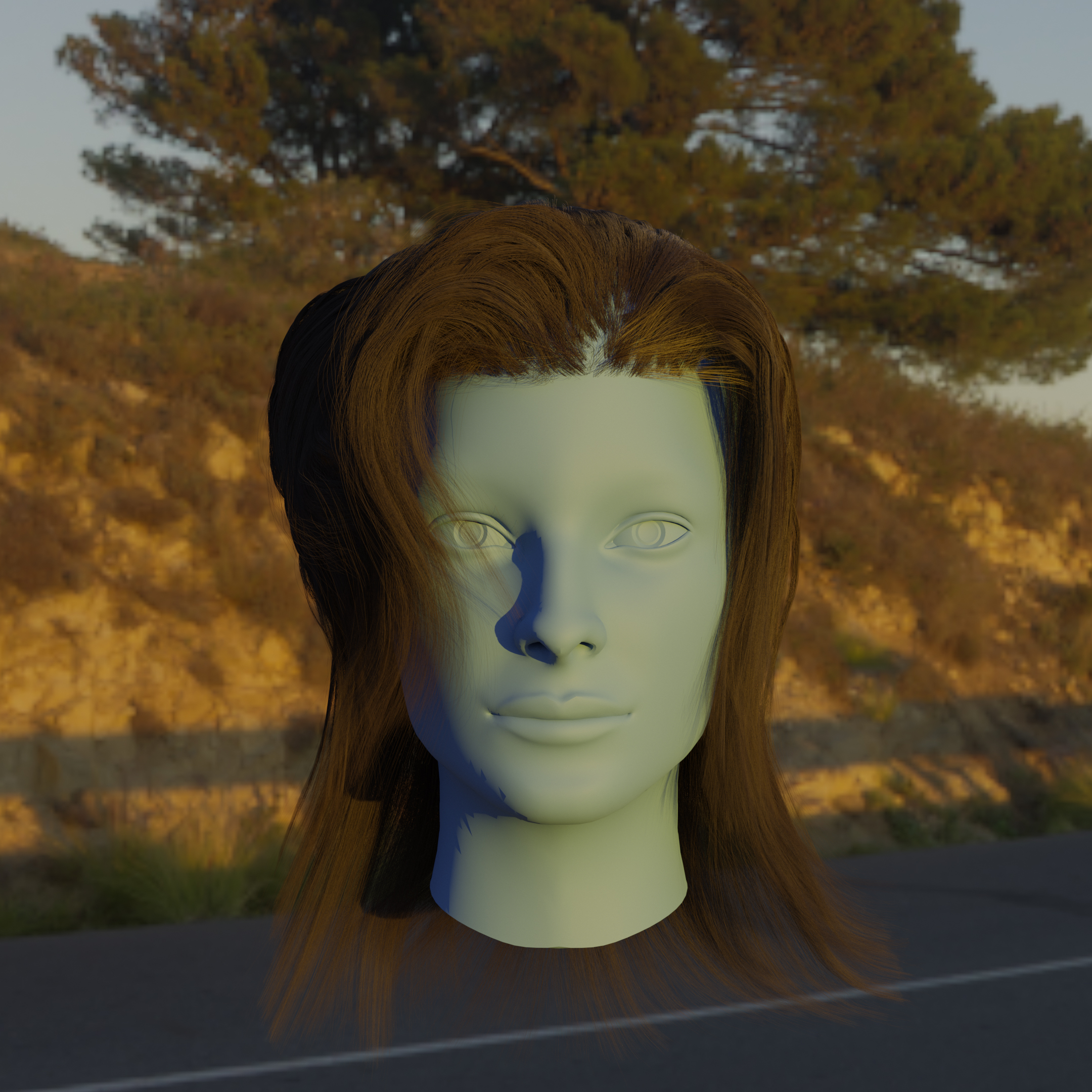

I find strange bug while trying to transport scene from Cycles to LuxCore. All materials and meshes work fine, except hair. It gives me error notify (pic 1). In other scene simple hair works pretty fine. Sometimes changing values in hair render and viewport menu (pic 2) let me render hair in viewport . But I didn't find any dependency between these moments. In blend file hair cause problems are disabled, just try to enable-disable it.

So I did like you said - now problem is solved and everything works fine except one thing. In viewport some strands align to center of coordinates. You can see it on screenshots below.

So I tested 2.5 in hair rendering, and it's look pretty nice.
Do you planning to implement any special shader for hair (like Principled Hair bsdf)?
