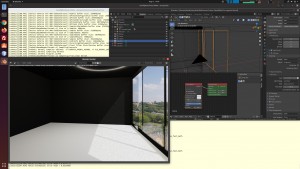

You need to enable architectural glass on window material or it will a scene extremely difficult to render for a path trace:
You should also disable "Out of core" rendering, I doubt it was intentionally enabled.
There are also hundreds of point light sources (i.e. the circle on the ceiling): it is a quite killer setup for rendering times.

Dade wrote: Wed Aug 12, 2020 12:13 pm You need to enable architectural glass on window material or it will a scene extremely difficult to render for a path trace:
I actually did enable out of core intentionally but mostly because I was getting some crashing in the full scene and that seemed to lighten up on the crashes. I don't understand it well enough to know why it's working so maybe you can help explain why that reduced my crashes but I will turn it off if it is a bad idea. And the hundreds of point lights are gone. They were ported from another model I had made in a different engine which runs pointlights with physical scale and has no effect there. I changed it to a mesh light. I started running architectural glass too. I don't love what it is doing to the realism of the inside of the doors but I am going to put bloom on it anyway so at that point I am sure architectural is going to be just fine.
Thanks again for taking a look and if you are able to help me better understand why to / not to use out of core rendering I would love to know, and if you have any idea why it was helping with render stability.
Also, while I have you, is there a huge difference in regards to caustics when using path gpu with light paths instead of CPU BiDir? I know originally you needed BiDir for caustics but I saw light paths and have been using that. I see a huge leap in render time being able to use my GPUS but BiDir seemed brighter over all, but BiDir didn't seem like it was making any serious changes to the caustics vs light paths so I am also kind of curious about if theere is a reason to or not to use light paths situationally besides the obvious which is, you do or don't have caustics. But are there any other benefits or repercussions to doing it one way or the other?
