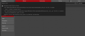

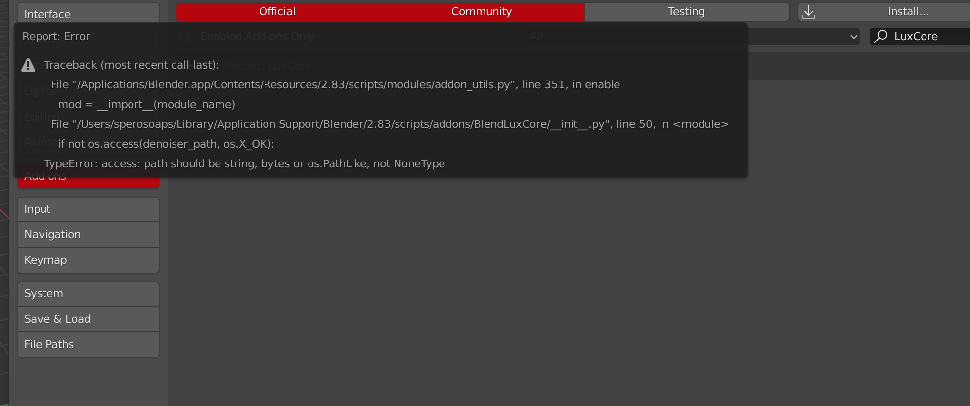

I got the beta 2.4 edition because I was told that it would work in blender 2.83 and when I went to install it, it wouldn't install and came up with this error:
Why?
Re: LUXCorerender beta 2.4 refusing to install in blender 2.83 official build
This may have already been fixed, can you try to install a daily build ? viewtopic.php?f=9&t=736
