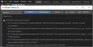

Activate error

What version of Blender is this?
Is it some custom or buildbot build?

Re: Activate error
hi, it's version 2.83.2
Also try 2.80 and 2.82, always the same error.

Re: Activate error
I can not reproduce the problem.
It sounds very weird. DATA_PT_uv_texture definitely has a member COMPAT_ENGINES, if not, it means your Blender installation is broken somehow.
>>> bpy.types.DATA_PT_uv_texture.COMPAT_ENGINES
{'CYCLES', 'BLENDER_WORKBENCH', 'BLENDER_RENDER', 'BLENDER_EEVEE', 'LUXCORE'}

Re: Activate error
Hi, after removing an add-on the problem was solved.
Unreal engine exporter caused some kind of conflict...
Thanks for the help!
