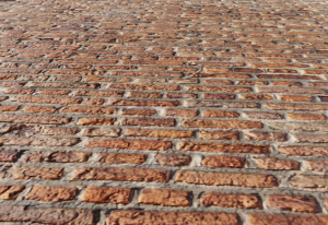

This is the first material:

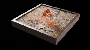

and when I mix them, using the bump from the mix material node, this hapen:
I get those black spots, doesn't matter if I reduce the strength and if I use the bump slot of the materials instead of the bump slot of the mix material, I dont get the relief

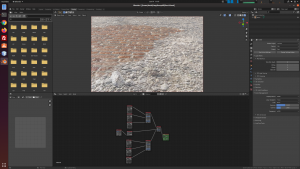

Well, I found a solution but a really bad solution in my opinion. Mixing the maps instead of the materials... Mix both albedos, roughness and normals and them, plug them into the material
here it is without those black spots... It works but the way of making it, is really ridiculous

You have a bump map connected both to the a disney and the mix node. It looks to me like it works fine if you simply connect each bump map to each Disney node and than mix the 2 Disney nodes:
