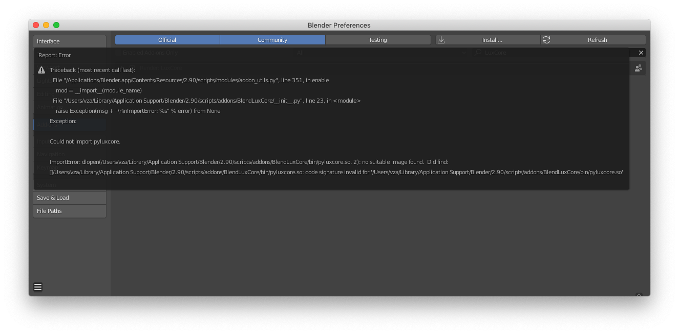

I deleted Library/Application Support/Blender/2.8...(all versions). I installed blender 2.90 and BlendLux 2.4. Same error:
CODE SIGNATURE INVALID for PYLUXCORE.SO

juangea
Posts: 332
Re: BlendLux doesn't work after installing another add-on
Post by juangea »
It seems it’s a failure in the code signing of the latest mac build, check the last phrase of the error, it’s not related to your computer specifically I think

juangea
Posts: 332
Post by juangea »
Well, maybe that addon broke something, but I find that improbable, but the error seems to be clear about the signing problem.
Anyways, it seems that the signing code problems have been solved and the next azure build will have that solved, test it and see if it solves your problem :)
