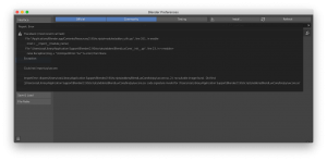

Hello! I'm so sorry for all my posts!
I installed modular_tree add-on in blender 2.83 and now I can't use BlendLuxCore in every version of blender on my Mac (2.80, 2.81, 2.82).
I tried to uninstall that add-on, uninstall and reinstall BlendLux, but nothing. What can I do?
Thank you!

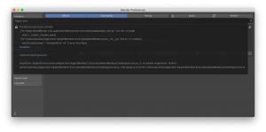

I deleted Library/Application Support/Blender/2.8...(all versions). I installed blender 2.90 and BlendLux 2.4. Same error:
CODE SIGNATURE INVALID for PYLUXCORE.SO

It's the same with all Blender versions, from 2.80 to 2.90.

It seems it’s a failure in the code signing of the latest mac build, check the last phrase of the error, it’s not related to your computer specifically I think

Well, maybe that addon broke something, but I find that improbable, but the error seems to be clear about the signing problem.
Anyways, it seems that the signing code problems have been solved and the next azure build will have that solved, test it and see if it solves your problem :)
