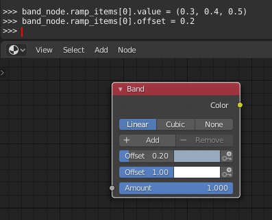

Ok, This is the result of my script! Last question: How can I change the colors of slots?
I've tried "ramp_node.ramp_items[0].ColorRampItem = (0.4,0.2,0.0)" but it didn't work. :oops:

You should use gamma = 1 for the roughness map.
vza wrote:
Fri May 15, 2020 2:53 pm
Like this:

Post by vza » Fri May 15, 2020 3:51 pm
Now it works! :mrgreen: Thank you so much!
