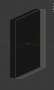

This is a simple setup.

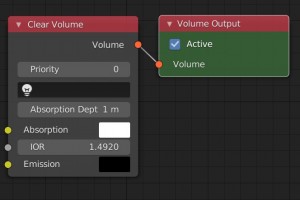

A block that is made from two materials - one is a black one and the other one is clear. Both are with almost perfect polished surface qualities. this is the material for all faces black to air: this is the material for all faces clear to air: this is the material for the face that both materials share: Does the luxcorerender algo takes into account the little remaining difference in IOR of black and clear component?

Re: reflectivity on a black material covered with a clear one
The glossy IOR has nothing to do with volumes and it doesn't affect them in any way. The Glossy IOR affects the specular component of the glossy material like if there was an air/material interface, it just a different way to specify the amount of specular component: https://wiki.luxcorerender.org/LuxCoreR ... or_and_IOR
I still don't understand what are you trying to achieve, sorry for that.
let's put an actual example, for example, a table top made out of Black Acrylic with a Clear Glass on top of it?
That's what you want?
Because what I don't understand is why are you using volumes at all, unless you want the glass to not be clear, but rather to have some volumetric absortion.
ALso I don't understand the material that you say that is for the faces that both materials share.
In the end if you have two surfaces you just have that, to surfaces, each one with it's material, and the "mix" will be done by the engine, like in the reality.
Please confirm if my example with the table top is what you are trying to achieve, and why do you want to use volumes, I actually don't understand why would you want to use volumes here.
