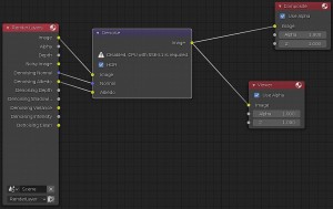

@juangea, you was right! :(
It is not supported by my CPU:

I was suspecting that, what Mathieu said was not making much sense to me, because OIDN says it requires SSE 4.1, even if you compile with SSE2 suppport, if it uses something from the SSE4.1 instruction set is not possible to make it compatible.
Mystery solved! 👍
