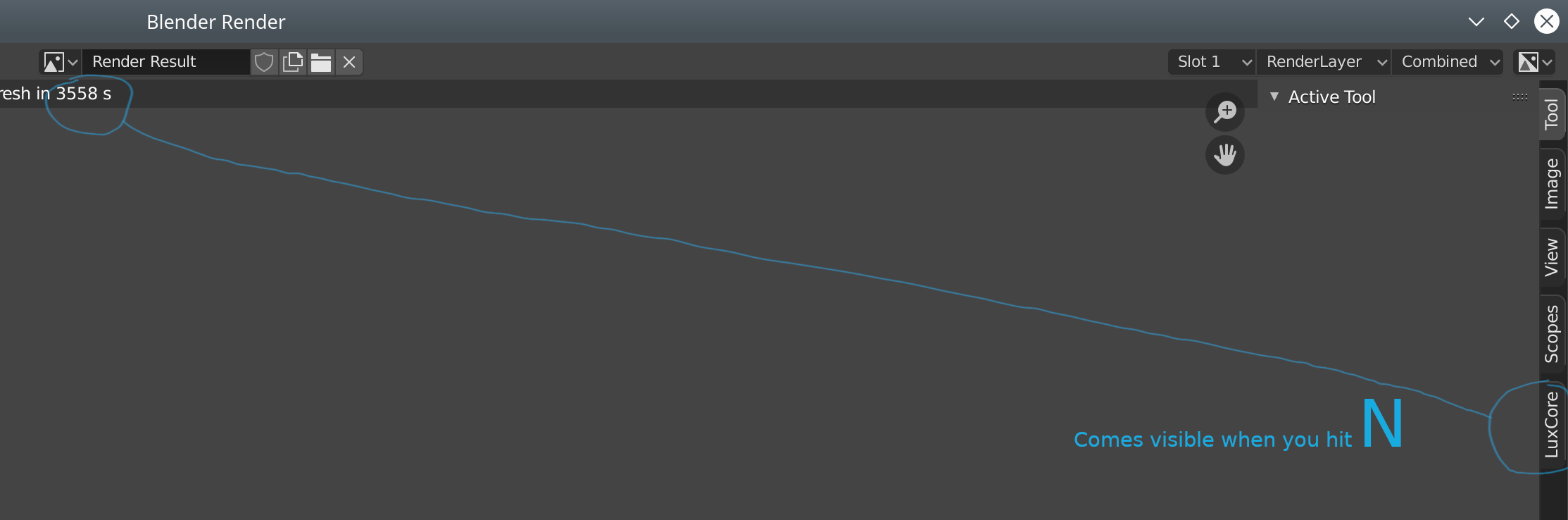

It could be the refresh interval, at least for me, it's the only thing that makes blender unresponsive.
- You can start render at small resolution
- hit N
- go to LuxCore panel
- change 10 to 3600
- stop render
- set resolution back to high
- start render

I really can't find how to set the timer before render start.Theo_Gottwald wrote: ↑Mon Jun 15, 2020 1:01 pm So will have to look for these "Refresh cycles" where they are.
What exactly is the reason that i must set it to low resolution first?
The lag doesn't let you to change the value, so better to start with small resolution. After that it remembers last used value.

Yes, now i understand. I render it with a low res, then its automatically set to a low value. Then increase Resolution and it will keep the low value.
Good trick!
