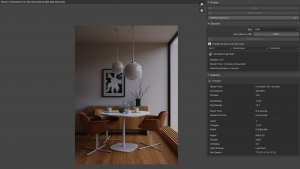

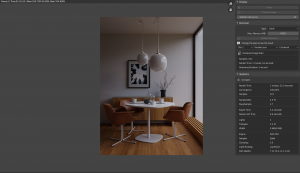

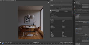

So, here is the thing, the computer is this one:
CPU: [email protected] all cores - 32 cores/ 64 threads
GPU: GTX1080 FE Stock
RAM: 64Gb@3Ghz
Operating System: Linux Mint (ubuntu Base)
I'm getting a super weird performance with CPU.
This are the render tests:
This is OpenCL - CPU+GPU - Halt Condition 512 samples:
This is CPU only - Halt Condition 512 samples too:
This is GPU only - Halt Condition 512 samples too:
SO as you can see the CPU only, despite being quite faster than the GTX1080 is reaching 512 samples at a much lower speed than the GTX1080 alone, I don't understand anything.
Some ideas on what's happening?
Also notice the noise, it seems to be less noise in the CPU only render than in the GPU only render.
BTW the CPU threads are always 100% load in CPU or OpenCL-CPU+GPU.
Some insight of this would be very welcome to be able to level the render in a mixed farm CPU's only and CPU+GPU.
Thanks!

Re: Weird behaviour... GPU faster than CPU when it should not...
I tried also using Noise threshold.
Weird results too.
Same noise threshold, the CPU is still faster than the CPU, but I get more noise from the GPU than from the CPU.
What's happening?
CPU only:
GPU Only:

CPU only:
GPU Only:
