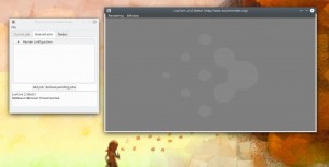

:D Yeeeey, got it working :D
The commands for virtualenv are little different.
This tutorial was very helpful https://www.youtube.com/watch?v=fv8YxO3AJqg
Installed Python 3.7.4
python3 -m pip install virtualenv numpy
pip install --upgrade virtualenv pip
python3 -m pip install virtualenv pyinstaller
python3 -m pip install virtualenv PySide2
