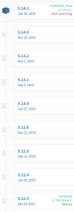

Dade wrote: Sat Feb 15, 2020 12:33 pm It looks like a problem in the PySide2 version you have installed: you may need something older or newer, it depends on what you have installed.
It's the latest pyside2 5.14.1
I will check the older versions.
Fox
Posts: 437
Re: Linux Compiling LuxCore
Post by Fox »
I went to the pyside2 version that worked in Windows (5.12.3).
Still same error:
TypeError: 'PySide2.QtWidgets.QWidget' called with wrong argument types: PySide2.QtWidgets.QWidget(MainApp)
