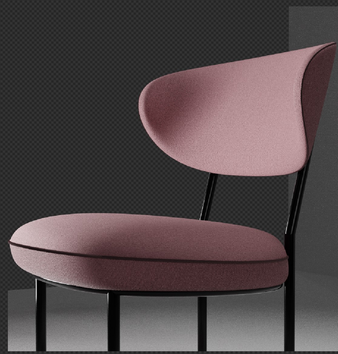

I also noticed this, in Cycles they give like the velvet effect.
Usually we need to force it more than 1.0, to 3 or 4, but I also noticed that in Lux it's capped at 1.0, depending on the effect it should give may be reasonable to remove that upper limit.

Well yes it should create a bit of backscatter effect for quick cheap cloth look but in luxcore it doesn't seem to do anything.juangea wrote: Fri Jan 03, 2020 8:09 pm I also noticed this, in Cycles they give like the velvet effect.

Yes, I see the same, no effect at all in lux.

hm. so it does seem to work, but very weak.
no sheen sheen
no sheen sheen
