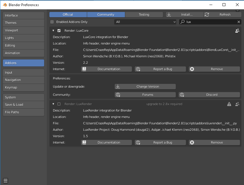

So id like to start off by volume scatter, how to add this so i could see caustics like viewtopic.php?f=3&t=1430 ? in the new version?
Theres a blender file to download in that forum- when i opened it i got an error saying luxrender is not found. whats the difference between lux render and lux render core? is it the standalone release?

All the .blend here, on the web site and wiki are for the newer version. Are you sure to have correctly installed BlendLuxCore ? Check https://wiki.luxcorerender.org/BlendLux ... stallation
I downloaded the file and it worked just fine for me, seems you don't have LuxCoreRender installed, download it here:
https://luxcorerender.org/download/
the installation steps are already provided by Dade's reply
also,
luxRender = is the old LuxCoreRender
LuxBlend = is the old blender exporter to LuxRender
LuxCoreRender = is the current stable version
BlendLuxCore = is the current blender exporter to LuxCoreRender
http://www.cgchannel.com/2018/05/luxren ... ender-2-0/
TLDR:
LuxCoreRender is the newest version of LuxRender
Hope all that helps :)

I see, names are so confusing.
So I have LuxCore. isnt that enough?

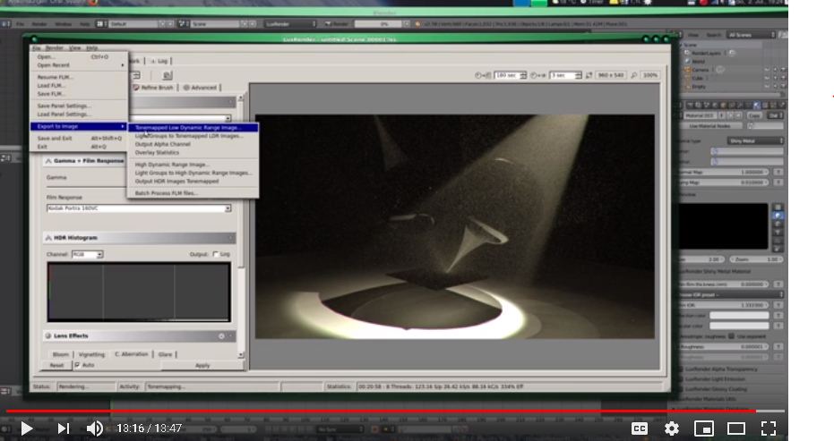

i suggested new tutorials because- older version have lots of difference. specially for light scattering...
https://youtu.be/PrHWwH_VXlk?t=371
Added a volume and i cant find the option he says as ""clear"" now i cant find it in this version.

crazerep wrote: Wed Oct 23, 2019 8:56 am Added a volume and i cant find the option he says as ""clear"" now i cant find it in this version.
That tutorial was made for the old LuxRender (1.6).
The first version of the new LuxCoreRender was 2.0.
We could indeed use a lot more tutorials - we need people willing to create them.
About the volume question: You need a volume node tree and in the add node menu, you will then find the different volume types.

Thank you! BYOB.... now lost again because in the volume panel of that tutorial he can add 2 volumes.
Can you share the simple node setup to have the light ray scatter in a cube? like this man has done :D

crazerep wrote: Wed Oct 23, 2019 10:54 am Thank you! BYOB.... now lost again because in the volume panel of that tutorial he can add 2 volumes.
LuxCore now only uses the "interior" volume that you see in old videos like that. For "exterior" volume, if you need to customise it, check the Volume panel under the World tab.
Rather than set the volume interior/exterior for each face, LuxCore uses a priority system for overlapping volumes. Each object will encapsulate a volume, and the one with the highest priority "wins". For example you can put an ice cube in a body of water, and give the ice cube volume a higher priority in order to override the water volume inside that space.
Edit: Or in that video example, probably you'd set a volume with higher priority for the glass sphere so that it's separate from the dusty air volume. i.e. dusty air volume could be 1, glass volume could be 2.
Edit 2: Actually ignore what I said about volume exterior, there is still one. :lol: :oops: The part that was correct is the bit about priorities for overlapping volumes.
