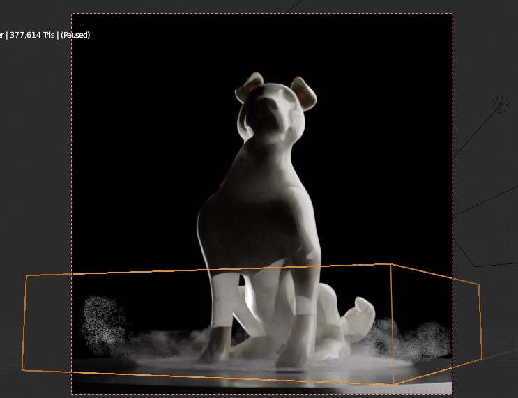

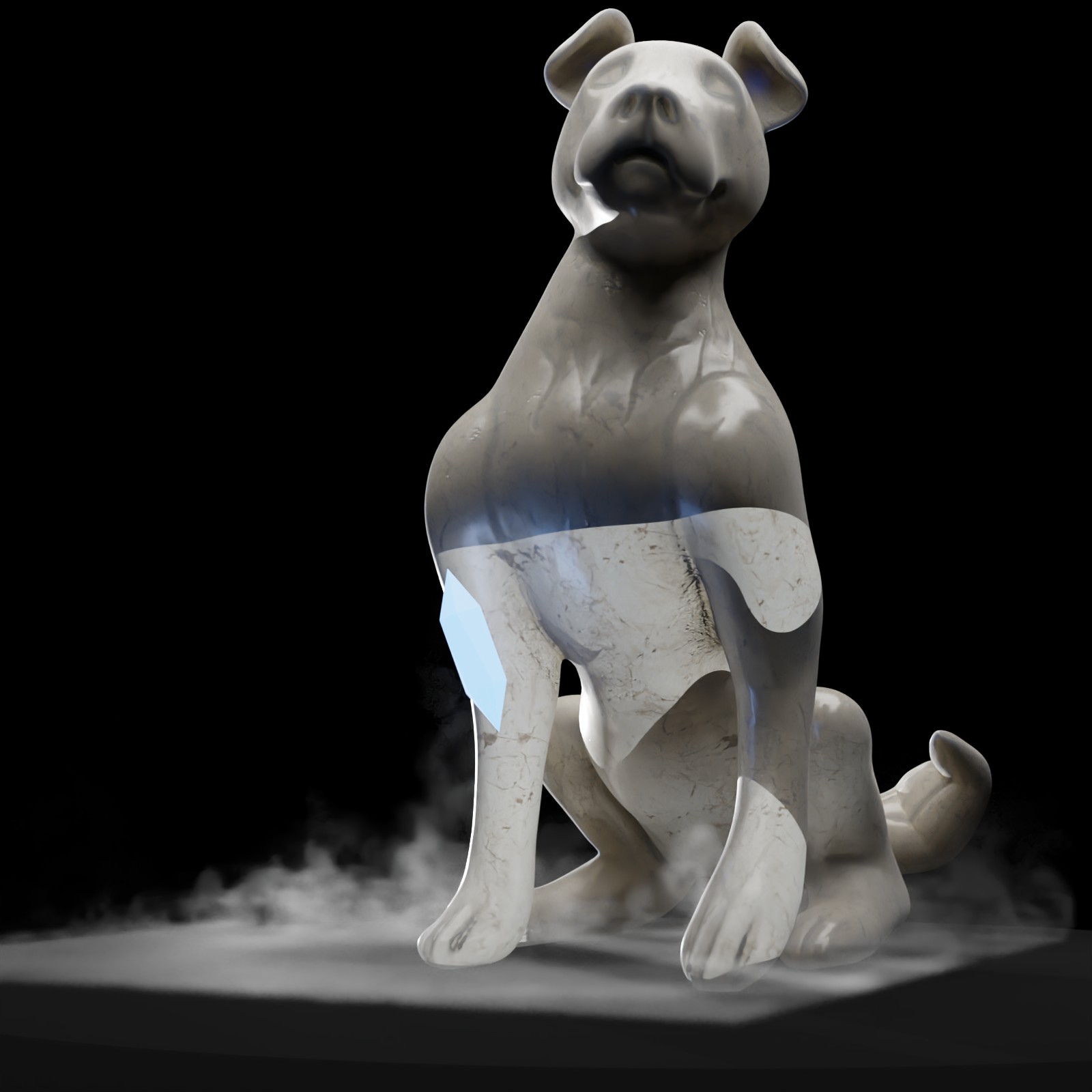

I found strange behaviour while using smoke in blender and rendering it with Lux. Here u can see example scene: smoke domain intersect marble dog figure and enlight dog volume. Figure is smoke collision effector and doesn't really intersect smoke. If change priority value of volumes - it can only cut a part of dog but nothing else.
To see difference just disable smoke domain rendering in outliner

Interesting scene, the spotlight seems to be the problem, it illuminates the smoke and visually cuts the dog in half.
Spotlight appears the problem, not cause it.

It is working fine here:
and it wasn't before (the posted scene doesn't include smoke data so I'm using an homogeneous volume both cases).
What kind of result do you get ?
