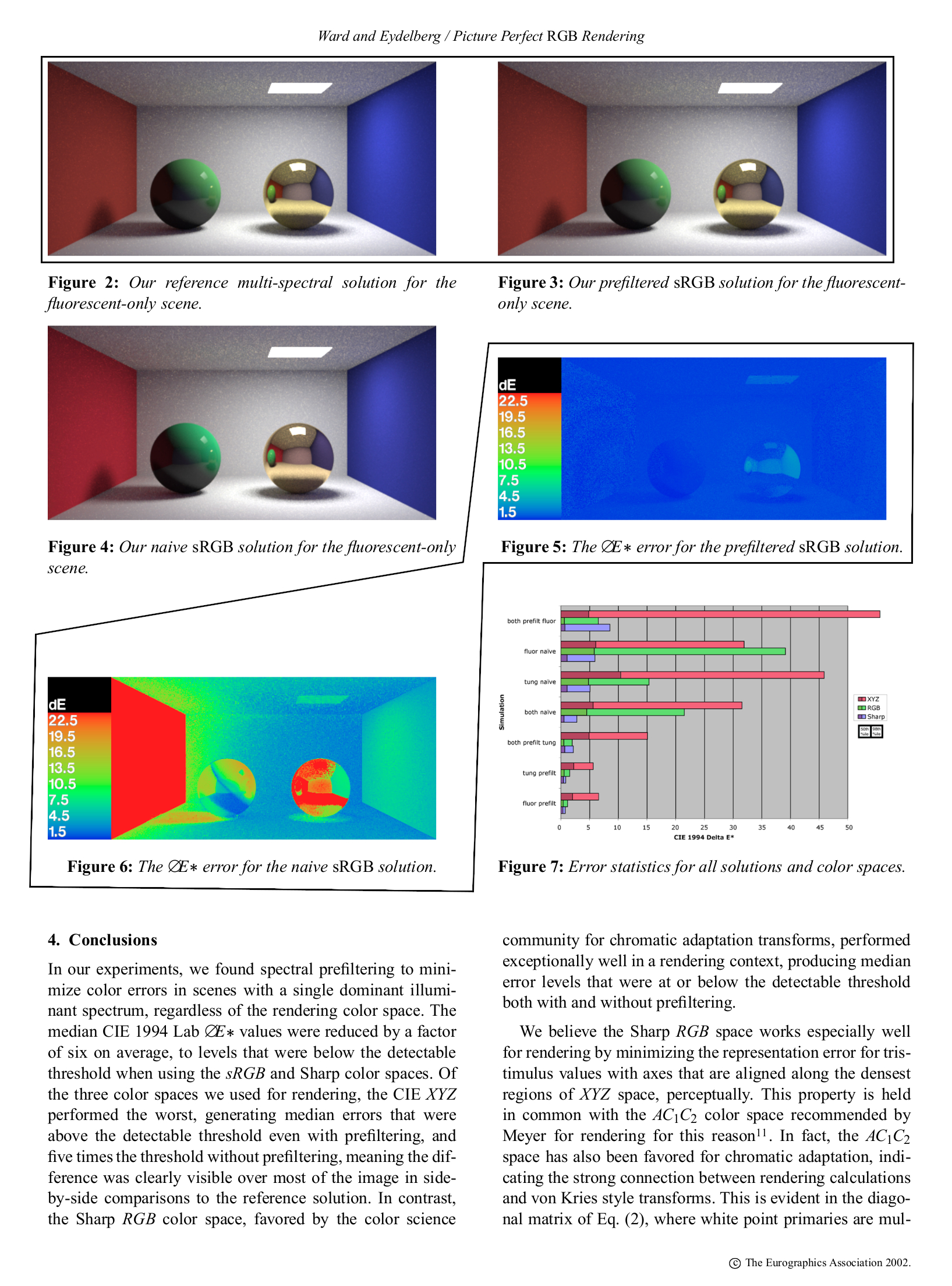

Post by Sharlybg » Sun Oct 18, 2020 12:59 pm
This thing deserve a try look at the error level compared to full spectral and naive RGB

Post by MetinSeven » Sun Oct 18, 2020 2:00 pm
Interesting!

Post by Theo_Gottwald » Sun Oct 18, 2020 8:05 pm
, or reduce
all the spectral data to RGB values and fall back on three
component rendering again.
They suggest exactly what i said above. They want render a R,G and B Sample and each with the frequency dependent Material values.
Then they sum it together. I think that is also what they did with POV-Sample above.

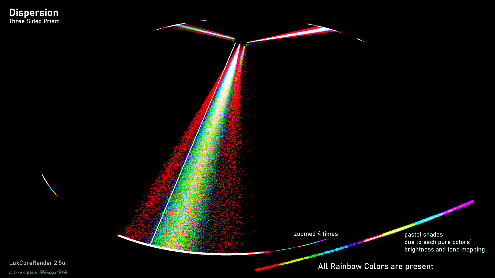

Post by FarbigeWelt » Tue Oct 20, 2020 7:17 pm
Three Sided Prism
Three Sided Prism
