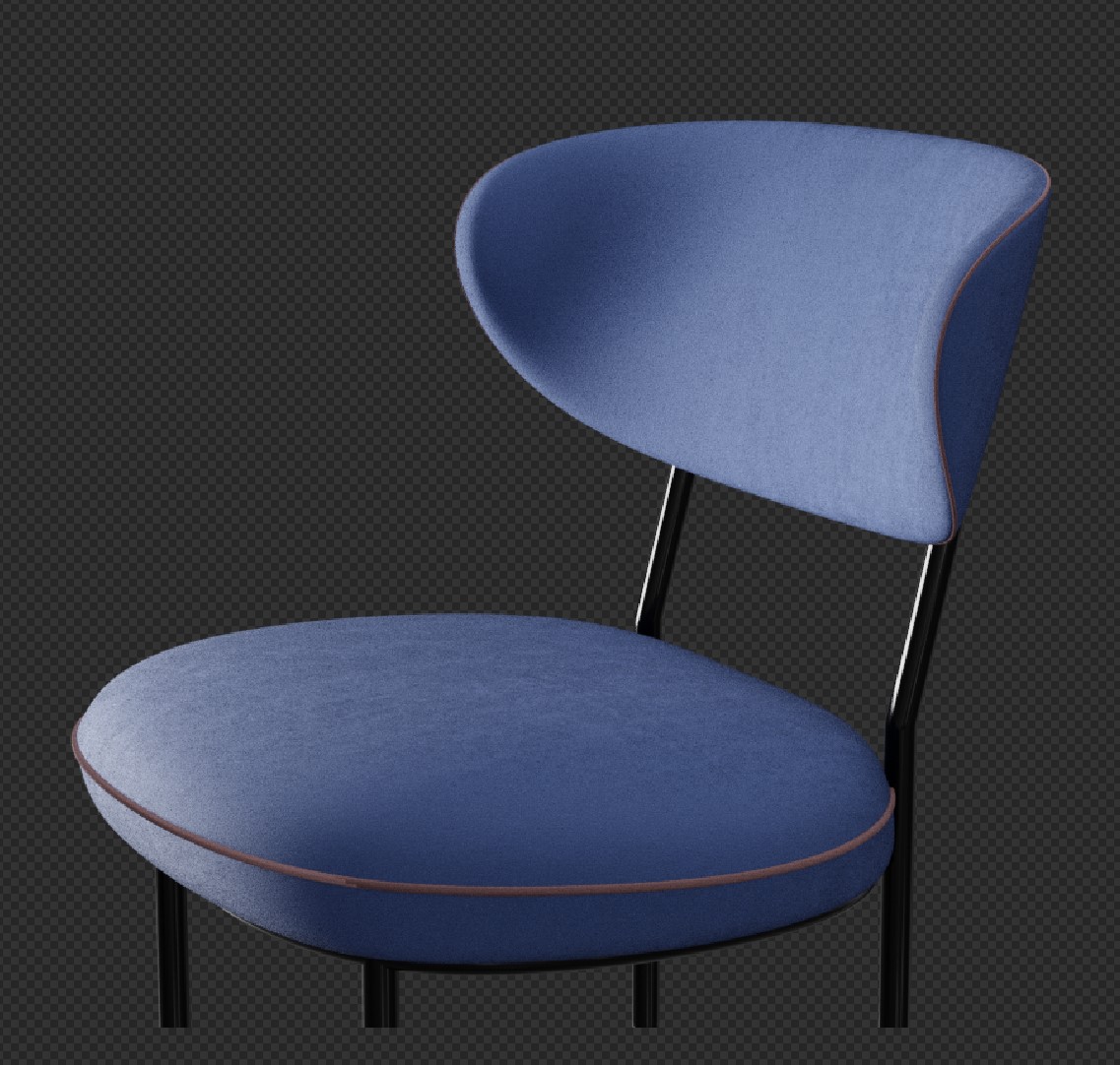

seems when you were fixing bump mapping you missed mx material..
disney
mix material(set 100% to use only second slot which is the same disney as example before)
Velvet gets also ruined by bump mapping....
							mix material and velvet have broken bump
Re: mix material and velvet have broken bump
This is likely to be the same problem described here https://github.com/LuxCoreRender/LuxCore/issues/198 and I fixed the problem today.
