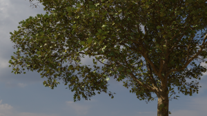

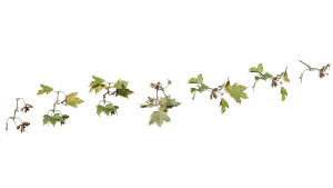

Here are a couple test renders of the Sycamore Maple Twig. The idea is to use only the textures provided by The Grove. Since Lux doesn't support separate backfacing textures, I used the solidy modifier to get a separate backside set of faces.
I created a few versions of the original two twigs by removing leaves. These were then placed into Apical Twigs and Lateral Twigs collections with Pick Random chosen, for variation. The middle twig is rotated to show the backside.

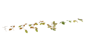

Post by CEROE » Tue Sep 08, 2020 11:11 pm
European Beech

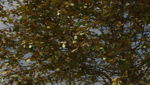

Post by CEROE » Wed Sep 09, 2020 7:01 am
Walnut

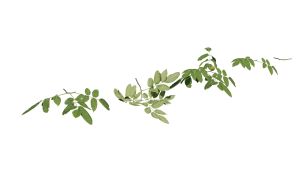

Post by CEROE » Wed Sep 09, 2020 7:02 am
Western Red Cedar

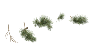

Scots Pine
