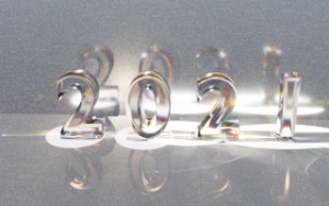

So this is the final DENOISED Picture. It took 14:41 Minutes to render
with 50K Samples per Pixel and Denoiser.

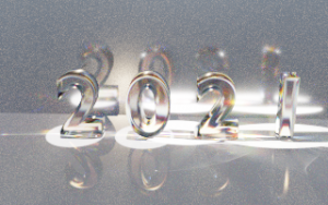

Here it is before Denoising.

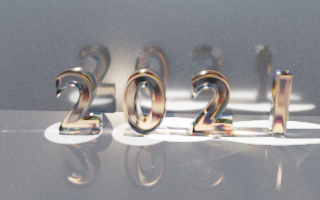

This one was rendered in 11:14 with the CPU, BiDir and Metropolis

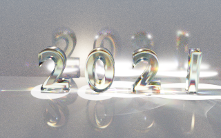

This one was rendered in 11:36 with the CPU, BiDir and Sobol.

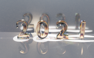

This one was rendered using the CPU only, Path Tracing and Sobol in 5:40 Min

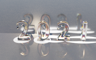

And this one was rendered in 3:07 Min using OCL, GPU+CPU, Sobol.
