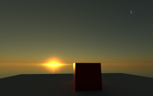

With no camera volume instead of auto volume detection:

Yes, that's better! I see how different horizon line is. There's no difference if bump is disabled though.

To me it looks like the horizon line is wrong without volume, because the camera rays start in the incorrect volume, so they do not scatter regardless at which distance they hit the ocean surface.
There might or might not be bugs in the volume system, but from what I can see this scene is not affected.

This scene, in my opinion is not affected, at least at 1300 samples. Did you have bump on sea enabled while render with disabled camera volume? Because I try to disable both bump and camera volume and didn't see any difference with picture with camera volume and no bump.

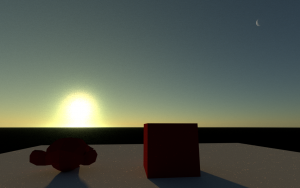

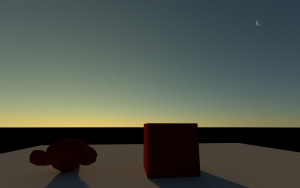

I have disabled scattering on all atmosphere layers, then re-enabled it one by one to find the one responsible for the fireflies, and it looks like the "Glare" layer is the sole culprit.
It seems to be caused by the high Asymmetry: Values higher than about (0.7, 0.7, 0.7) seem to increasingly create fireflies, and the glare layer has asymmetry (0.93, 0.92, 0.92). Can the volume scatter code be optimized to better sample such strong directed scattering?
(4 minute renders on RTX 2080 below)
Scattering in glare layer enabled
Scattering in glare layer disabled
