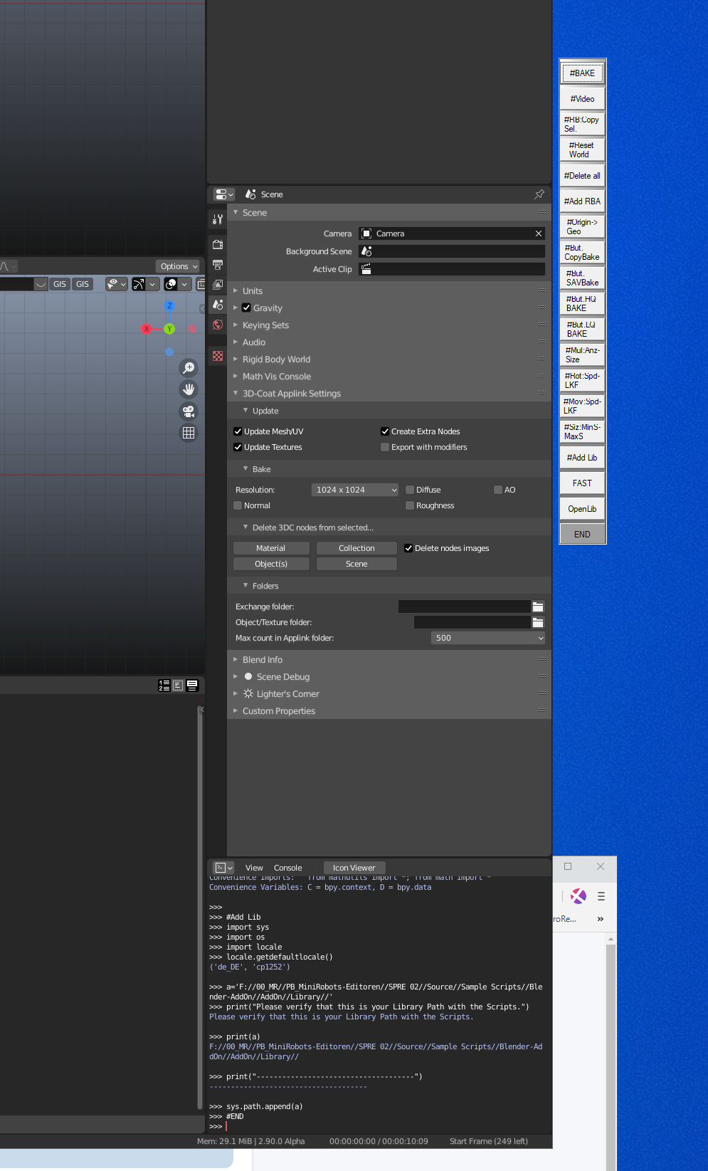

This AddOn plus Library is free. I made it for myself when doing Rigid Body stuff.
The Point is that in Blender you never have enough shortcuts for keys.
And then especially for Rigid Body etc you have to go to ... Cache .. Bake usw.
So i packed it on a button which will then type the needed Python commands into the Python Console-Window.
So its some type of Macro-Button Bar. It looks like this.
However each Button is configurable so you can put other commands on it.

To use the AddOn, you should know that it works only under Windows and it needs a Python console in the lower right corner of Blender.
Because it will type Python commands there.
Watch the Buttons:
- "Mul" this will multiply the selected Object in a defined cubic space
- "Rot" this will give all selected objects a unique random rotation within a given Frame number (and within a Speed range)
- "Mov" this will give all selected objects "Move" in random direction (limits)....
- "Siz:" this will give all selected Objects a random size within limits ...

Once you have the console in Blender open, you can start the AddOn, then press "Add Library".
This will register the Library Folder with Blender. The Free Public AddOn can have a total of maximum 20 Buttons which you can also put your own commands on.
If you want test the free AddOn. It is not limited other then it has only maximum 20 Buttons.
Please make sure that the Python console is in the lower right corner like on the picture.
Otherwise the AddOn can not type the commands and will not work.
