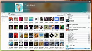

I wanted to share interesting found. An free opensource music player for Linux KDE.
I'm actually more happy with this, than with foobar2000 in Windows.
It does not play high-res audio out of the box in high-res (it's downmixed to 44,1 or 48kHz and 16bit).
